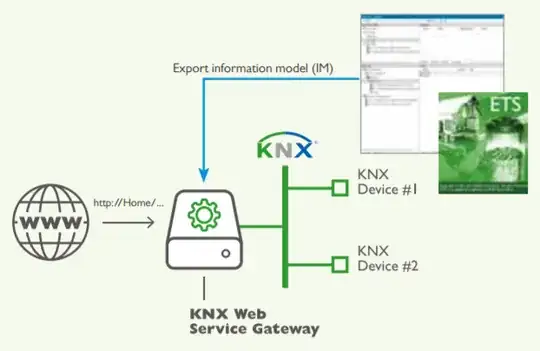

KNX_Architecture
The KNX WS specification foresees three flavors to ease the integration with an existing ecosystem: oBIX, BACnet/WS and OPC/UA.

I haven't found any complete products. However, you can download a complete software image for the Raspberry Pi of the KNX Web Service at KNX.org. It's free. The registration can be done with bogus information and 10 minute mail. Figuring out that the password has to be numbers only wasted some time though.
Anyways, after downloading that info package the zip contains a link to a 3.8 GB Raspberry image and a complete web service specification. Even without a Raspberry that image should be quite easily adapted to any other Linux system. Thus, you'd have a software KNX Web Service gateway with a service description.
Apparently since this is from October that's the best that's out there currently.
