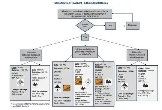

The document contains this flowchart for Lithium Ion batteries:
Classification Flowchart - Lithium Ion Batteries
The document details the requirements for testing, packing, labelling, and so on. You must also notify the carrier appropriately.
