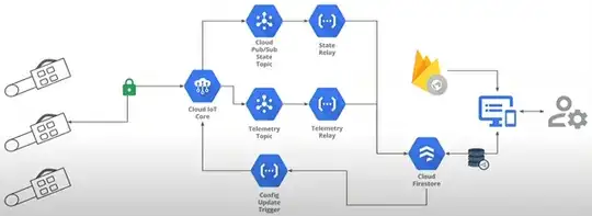

I have investigated the Googles firebase ecosystem and this is the “perfect” architecture if I understand it correctly:
  1. On the left would be my PLC communicating through MQTT to the Cloud IoT core service.
  2. From there the messages would get into the Cloud Firestore through Cloud Functions (by messages I mean the PLC config options and sensor data).
  3. The user would communicate with the devices via website that would be hosted on Firebase Hosting.
  4. And finally I could then save the PDF files to the Firebase Storage service.
At first, I found this all very exciting! I would have all my services under one roof, all at one place. The billing is not that bad either. But it would be a lot of work to setup everything properly.

Interesting approach. There are a few things that concern me here.
  1. you may hit API limits. See https://developers.google.com/sheets/api/limits
  2. I dont know if there's a limit on the number of versions. I wonder if each update makes a version ?
  3. Like you, I wonder if there are hidden costs to this, such as a per version cost.
