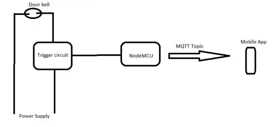

You can use a nodemcu with an external trigger circuit to develop your solution. Connect a relay or an electronic trigger circuit to generate trigger signal for the NODEMCU. So when the door bell rings, it sets a high trigger to the NodeMCU and this trigger can be used to send a signal to the MQTT topic.
A mobile app can subscribe to this MQTT topic to show the notification. A highlevel architecture based on my understanding is given below.
