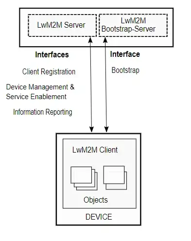

Figure: 4.-1 The overall architecture of the LwM2M Enabler
What I am trying to do now is understand how to utilise the LWM2M Bootstrap-Server as a LWM2M Client and document the workflow.
