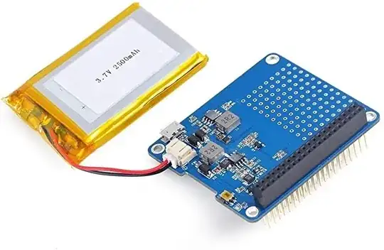

I have tried circuits like this but they are very poor, the battery does not hold up and unfortunately the charge readings through the GPIO are not realistic.
DollaTek Cappello ups con Batteria per Raspberry Pi 3 Modello B / 2B / B + | Adattatore Batteria | Fonte di Alimentazione Pi 3
