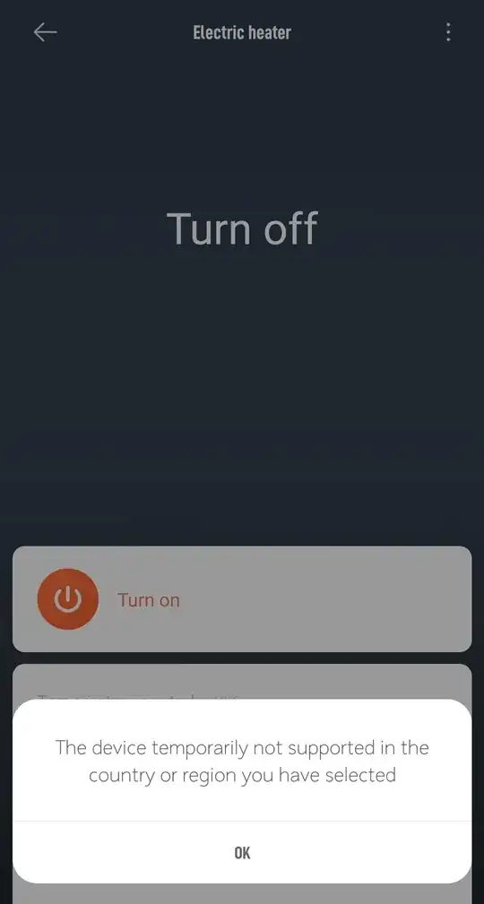

EDIT - I changed the region for my Mi Account to China Mainland and I was able to pair the heater, but when attempting to open it in the app, I get the below error: enter image description here

I have had the same issue. I tried VPN and DNS, but could not make it working. I have had the information from another website, you have to uninstall Xiaomi Home (probably rev 6...) and install old Xiaomi home (I tried 5.6.10 from 2019) and it worked. Only thing, think to remove the automatic application update in Playstore, because during the night I got update and had the same message error (and had to do same process again). I spent so much time to solve this, I want to share my happiness.

To work around the 'region not supported' error message in version 6 of the app, I suggest temporarily changing the time zone to China (in the settings of the device running the app)
