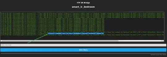

To get codes yourself you need to access to your tasmotized device through it web interface and go to "Console". Then get your remote control and pointing to your IR device push a button. You will see on console information regarding this button you pressed.
This information you will use to construct your own .json file like this (Samsung TV)

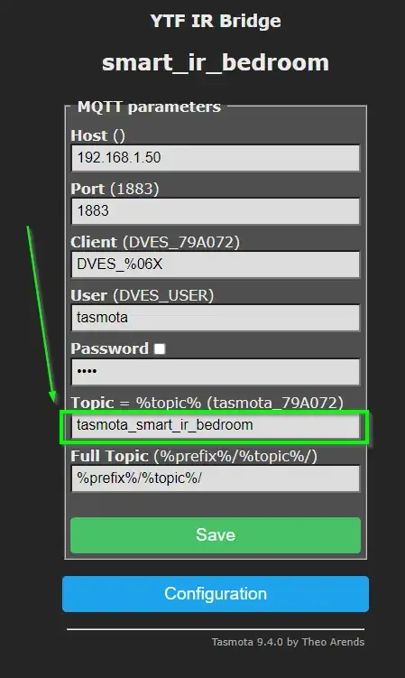

controller_data
Here you just need to specify the MQTT topic between some other parameters. MQTT topic is present on your tasmotized device configuration
cmnd/<your_mqtt_topic_here>/IRhvac for air conditioner
cmnd/<your_mqtt_topic_here>/IRsend for tv
Example of configuration.yaml configuration
