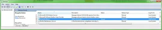

Installation was alright and I could start the Mosquitto Broker's service by using C:\Windows\system32\services.
windows service overview showing mosquitto broker service
