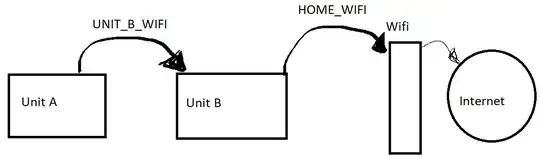

Unit A - ESP32
Unit B - what I am looking for
HOME_WIFI - The wifi network broadcasted within my home.
UNIT_B_WIFI - The wifi broadcasted by Unit B for Unit A to connect too
I currently have an ESP32(Unit A) device that I have setup and programmed to connect to a Wifi point and send data to a specific IP through HTTP requests. I currently have been testing that using my normal wifi within my home, but now I need to set up my relay.
What I need for Unit B, is to act as a Wifi hotspot so that Unit A can connect to and send information to it VIA HTTP requests. I also need Unit B to be able to connect to the actual Wifi broadcasted within the home that has access to the internet so that it can send the information it received from Unit A through the internet.
My thought process here is similar to how a cell-phone hotspot works. An unknown device connects to your Cellphone (which is the hotspot), and then the cell phone uses your cellular data to access the internet. I am hoping there is a way to have a Unit B with 2 wifi modules, one to broadcast as a wifi network to RECEIVE information from Unit A, and another wifi module to connect to HOME_WIFI and send that information to the internet.
The reason I have it set up like this, is that there are multiple Unit A's outside in this system and they all need a common point of access within the house, Unit B. So I just need a way for n Unit A's to connect to Unit B through Wifi, and to have Unit B still have to connect to HOME_WIFI and send information out over the internet.

If I have understood your question correctly, you want a wifi repeater in-between the esp and the home wifi connection.
You can accomplish that with off the shelf devices. (Routers that support third party firmware, devices boxed as repeaters, etc)
Or you could just use another esp. (like the esp32 wroom) and this github project: https://github.com/martin-ger/esp_wifi_repeater Just don't expect bandwidth miracles from the esp devices. If you need more than 4/5 Mbits of bandwidth, go with a device that was made to do this job! You can get a DD-WRT or openWRT firmware capable device on eBay for a couple bucks.
