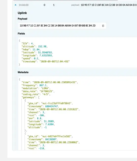

On the screenshot below you can see that the time the GPS was recorded differs from the time the package arrived in TTN: LoRa Uplink screenshot

Can you use the GPS timestamp that's in the message and ignore any messages that are older than say, 10 sec from the current time at the server (which is usually time synced to time servers) ? Make sure that you're using the gps timestamp and not the system time, which could be off by more than 10 sec sometimes.
