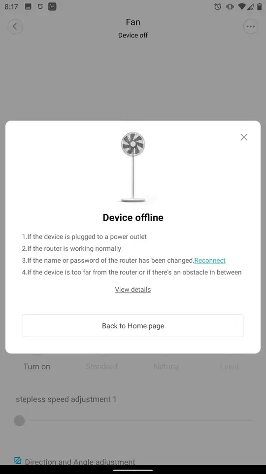

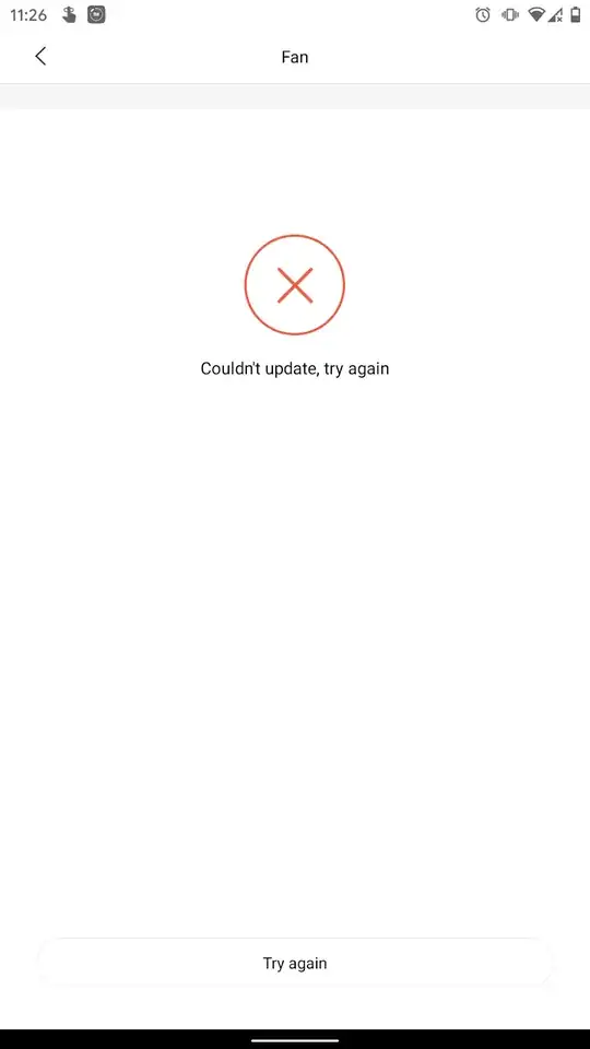

And now 95% of the time I see the Fan as "Device Offline" in Mi Home dashboard. Sporadically, it becomes available for few seconds and I can even start firmware update, but the update process fails, it never ends successfully (now stuck at 15%).

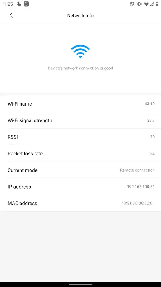

Screenshots: enter image description here
The problem is somehow related to my Wi-Fi hotspot (or Huawei router).
Working solution:
  • create a new WiFi hotspot or modify the existing one. give it a simple name ("OK") and a simple password (alpha-numeric, NO special characters!).
