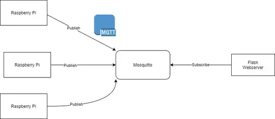

I have many raspberry Pis monitoring temperature and humidity in real time and publishing the data continuously to an MQTT broker (I am using Mosquitto at the moment). The Raspberry pis are all publishing to different topics. I would then like to send all this data to a flask web server, as in this diagram:

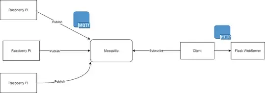

But Obviously flask can't subscribe to MQTT topics. I was thinking I could add an additional MQTT client that would subscribe to the topics and then it could send the messages over to the server via an http request in the on_message callback. This client would probably be running as a process on the same machine.
Is there a better way to do this?

First, you can definitively make you web server subscribe to MQTT, it's just the business of setting up a thread and providing the callbacks. Using the paho mqtt module for this, it's just a matter of using the Client class and calling loop_start() to launch the thread. However, depending of your needs, it may not be the best solution to make your webserver to subscribe to MQTT; it's not possible to say because you did not provide any details on your webserver specs.
You may also consider adding a database in your architecture. In your second setup, the "client" can push data in the DB and the webserver query data from the DB (MongoDB is quite simple to setup and use for such a use case).
