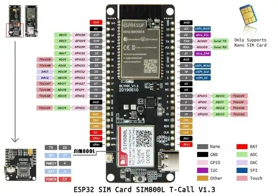

Well, my personal preference is ESP32 (I think that I do not need the Linux of Raspberry / Orange Pi), So I would use a Lilygo TTGO T-Call.
Here is a tutorial, including code, on how to use it to publish data to the cloud.
