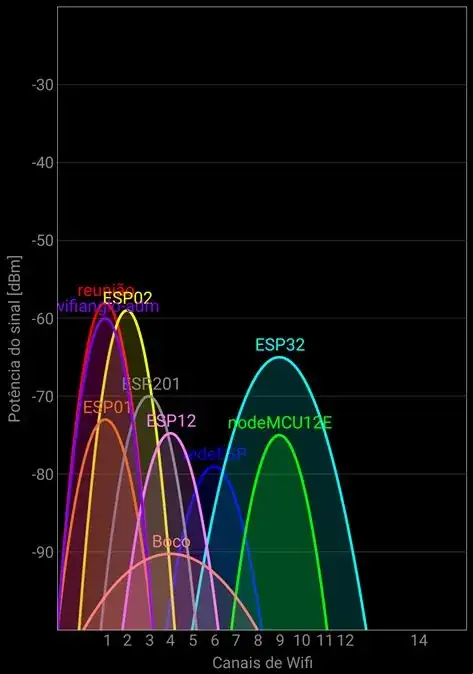

2.According to theseESP32 / 8266 WiFi Signal Strength:
Use WiFi Analyzer which is an application that finds WiFi networks available around us. It also shows the signal strength in dBm and the channel for each network. We will use it to do our analysis, which is possible through visualization in the modes: list or graph.
PHOTO APP --- The app can be downloaded from the Google Play Store through the link:
Wi-Fi Analyser App Link
After downloading the app create an access point in your ESP32 (Which is already done by you I guess) and connect your mobile with ESP32 Wi-Fi and open the App.
You will get a signal graph like this:
1. check the graph generated according to the intensity of the signal, both near the chips and in a more remote environment with walls in the way.
2. Close to chips - 1 meter. In the above image the first notes of the application. The best performances were from ESP02 and ESP32.

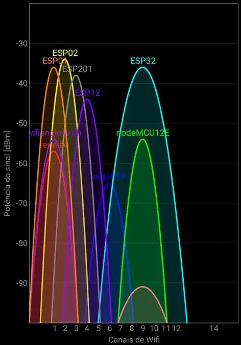

Moving away from the device 15 meters you will get a graph like:
In this second stage, the highlight again is the ESP02, which has an external antenna of its own.
