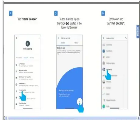

The image below shows the "Feit Electric" skill on the Google Home. How can I add my own device in a similar way?
Image of the Feit Electric skill showing setup process

You need to write a Google Assistant Smart Home Action and publish it.
The API you need to follow is documented here.
This will require a cloud service and a way for the cloud service to connect to the device (While Google have recently added local control, there still needs to be a cloud service for discovery/account linking/fallback control).
