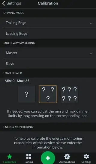

Having gone through automatic calibration, the light turns on and off fine at full power. However, when incrementing the brightness from 0%, the lights don't actually come on until around about 50%.
In the calibration section of the app, the load power is configured as 0-65.
LightwaveRF Calibration Screen

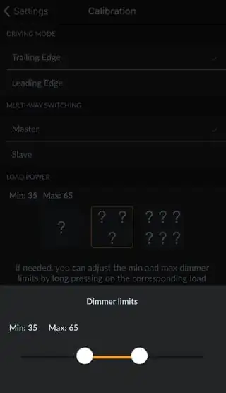

I've attempted to use the manual calibration options and have had some success getting the light to come on at lower percentages by upping the minimum load from 0 to 35 (for a new range of 35-65). However, when I do this, the 100% setting starts causing the lights to basically strobe on and off (not quite as bad as a rave, of course). This seems to persist even if I drop the max down below the 65 level.
LightwaveRF Load Power Manual Calibration
