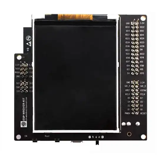

At time of writing, according to the PlatformIO docs, there is only one ESP32 with on-board debug support - the ESP-WROVER-KIT-VB.
It's slightly pricey, but has large 3.5" display. Here is a YouTube video of it playing Doom.
I am also looking at the JTAG probes which the PlatformIO docs say support ESP32, to see if one can be used for other processors, such as ARM (specifically STM32 boards).
Articles such as this one convince me that the Segger J-link ought to do the trick, and the J-link EDU is cheap enough.
Finally, much as I love ESP32, I have to accept that alternatives, such as STM32, have on-board debuggers, if that is a "must have" feature. I do like the look of the SRM32WB, which has both WiFI and BlueTooth.
I would love to stay with ESP32, especially the M5stack series, which allows plug & play attaching of hundreds of sensors and motors, etc, using Grove connectors, not to mention the "wristwatch" version. Alas, the M5stack won't even accept a JTAG probe.
There are a few ESP32 which support Grove connectors, either natively, or via Arduino shield if they have an Arduino pinout. I am examining those, one by one, for debug readiness via JTAG and will update this answer as I make new discoveries - although that is not part of the original question; it's just that my ideal ESP has debug + grove connectors + on-board display, maybe even eInk - obviously, YkMMV.
