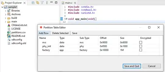

Option 2: Espressif-IDE
Use the Espressif-IDE, right-click on your project and choose ESP-IDF: Partition Table Editor, this way you have a graphic window where you can view/edit the partition table for your esp32 application enter image description here
