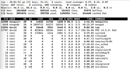

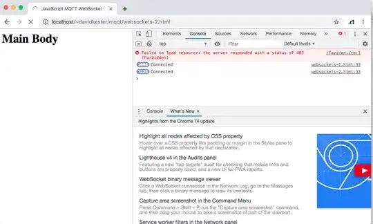

The problem is that the client connects to the broker, but is seems that is constantly running the "onConnect" function. In this function it is possible to subscribe to a topic and send a message, which works, but a lot, like 1000 times a second. This is the problem. But the computer running the client as the server starts running 100% CPU.
In the mosquitto broker logs I see the clients only connects once. I can still publish from other client (mosquitto_pub) on the same topic and you can see the message in between the thousands of messages being send from the Paho client.

A sample of what happens in the console:
