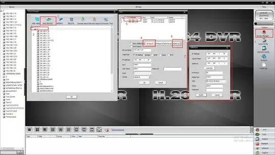

I'm using IP camera - as an input for my IOT project. IP cam default IP is 192.168.1.10 and in order to use it in my network I need to change its default IP.
My network address is 192.168.3.x. Seller instructions instructions are clear and reasonable, but my network address is not as his, causing IP SEARCH not to find this device.
I know that it is connected as needed since my NVR detects camera, with exact IP, but changing IP cannot be done using NVR GUI...
Any ideas ?

The I found quite quick and usefull- was like that:
  1. Connect IPCAM directly to PC's LAN port
  2. Change Adapter settings ( via Control Panel ) to 192.168.1.X
  3. logoff
  4. Connect using web page with default ip 192.168.1.10 and change to desired IP.
** this youtube tutorial helped a lot !
