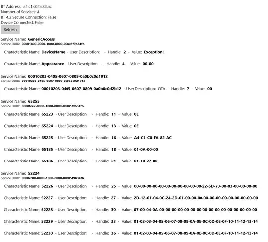

3. Using Windows BLE explorer. I installed Windows BLE explorer. I was able to connect to my device (see screenshot below) but I do not know how to identify the service associated with clock synchronization and how to access it.

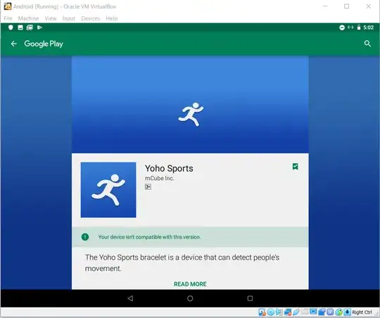

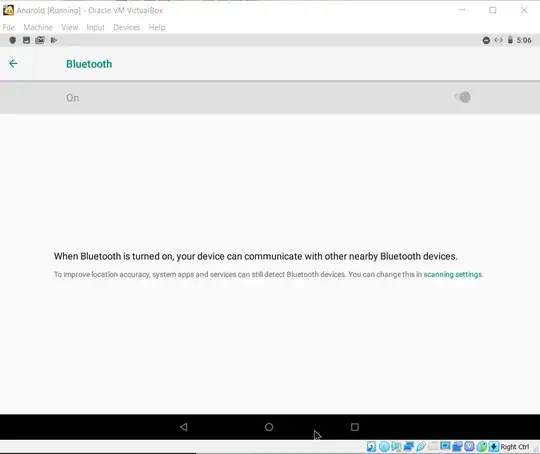

4. [EDIT] Using VirtualBox to emulate Android. This was suggested by SeanJ (see answers below). I was able to install a 64 bits Android on my computer using VirtualBox following SeanJ's instructions. Unfortunately, I ran into two issues.
  1. I could not get the Bluetooth to turn on: enter image description here
  2. When trying to download YoHo Sports from Google Play I got a message telling me this app was not compatible with my device: enter image description here
At this stage I think that buying a smartphone or borrowing one from a friend is my best option...

Use VirtualBox, you can install android and it supports bluetooth.
VirtualBox is a powerful x86 and AMD64/Intel64 virtualization product for enterprise as well as home use.
There's a pretty good guide here: https://www.howtogeek.com/164570/how-to-install-android-in-virtualbox/
Depending on whether your bluetooth module is integrated or plugged in, there are different steps to ensure operation but it seems a well worn path;
e.g. https://forums.virtualbox.org/viewtopic.php?f=3&t=83325

On the hope that they have used the existing GATT standards for current time services then you might want to have a look at this spec document
If they have just made up their own service then your only choice is to try and reverse engineer it. Tools like the ubertooth board may help, but you would need a phone to run the app so you can try and snoop on it. Or to try and decompile the app
