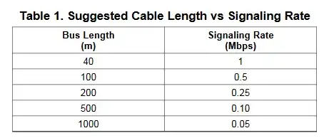

CAN is usable over 20 meters as well. From this Controller Area Network Physical Layer Requirements.
cable length vs signaling rate table
