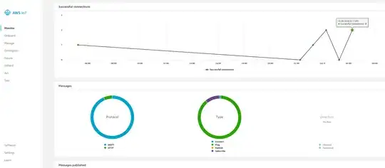

I appear to connect in the picture below, but it doesn't seem to be consistent. enter image description here

I managed to resolve the connection issues by removing the comments for the CA in the library I linked and uploading the Amazon root certificate to the board as a .der file as I showed in here
