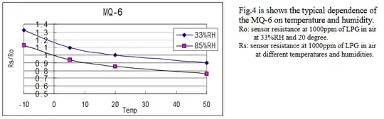

How can these weather conditions effect the sensor?
graph showing the dependence of the sensor on temperature and humidity
This is the figure you need.
