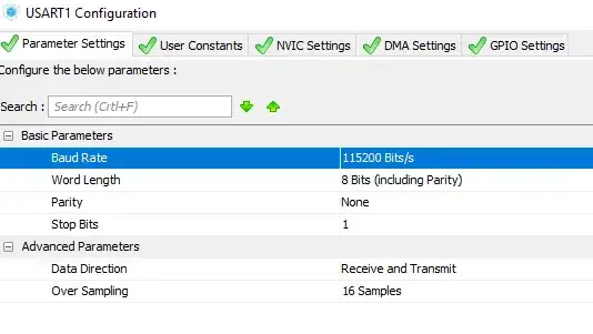

CubeMX:
UART configuration CubeMX
Code used in the STM32 (I am using the HAL library, the rest of the code is too long to post).
