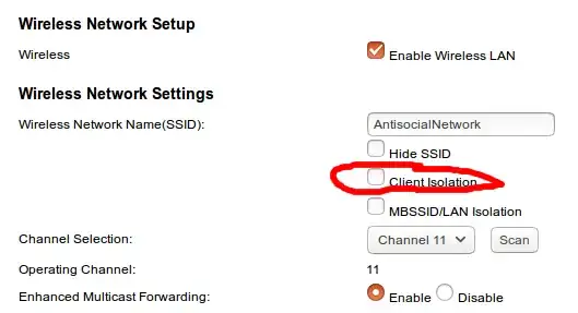

Well, technically, there is no such thing as absolute security. Doing so should be technically safe enough, if we consider that your router doesn't have any vulnerabilities and can separate the network well enough. Enable "Client Isolation" (or whatever your router company calls it) if your router supports it (It may be under NAS, Firewall or Wireless menus):
Client Isolation
