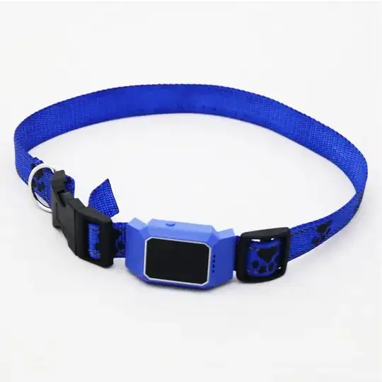

It's a Chinese product without a brand or model from eBay - "Pet Dogs Cats Sheep Finder Realtime GPS/GSM Tracker Waterproof For Android iOS" The product I'm using - GPS Tracker For Dog
Ebay Link

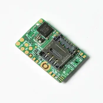

The product use MTK2503D GPS/GSM chip

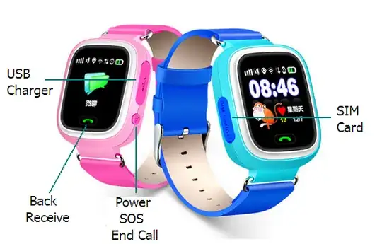

Similar Product from the same company - Children’s Phone Wear (BabyCaring) CY72 Children’s Phone Wear (BabyCaring) CY72 http://manage.5gcity.com/manual/cy72/CY72_LBS_122_ENG.htm
They have two more older models: http://manage.5gcity.com/manual/cy19/CY19D_144_ENG.files/image002.jpg http://manage.5gcity.com/manual/cy19/CY19_LBS_ENG.files/image002.jpg
