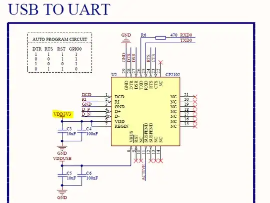

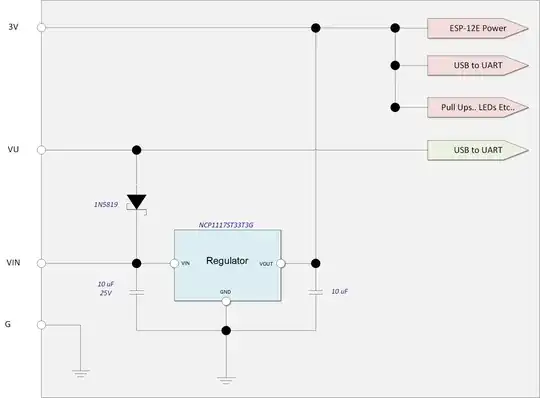

Yes, the schematic of the v1.0 NodeMCU shows that the 3.3 V bus is directly connected to the CP2102 chip.
You have two possibilities:
  1. Cut the 3.3 V trace on the PCB before the CP2102 chip. Not recommended as you will disable your programming interface and would be hard to restore it.
  2. The reset pin (RST) pin of the CP2102 is floating, you can try to pull it down to GND and keep the chip in reset, to see if that makes it any better.
