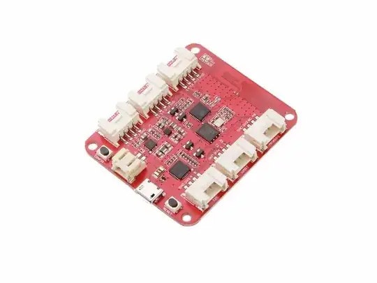

WioLink
pcb of the wiolink

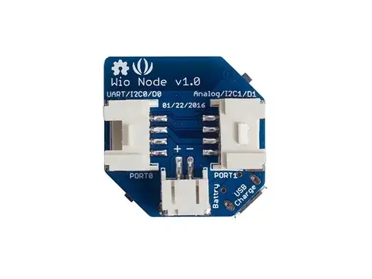

WioNode
pcb of wio node

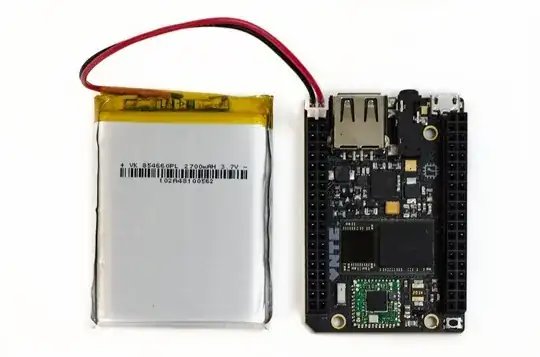

C.H.I.P ($9 computer)
C.H.I.P. pcb with battery pack

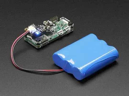

Raspberry Pi Zero + battery module Raspberry Pi zero with battery pack
