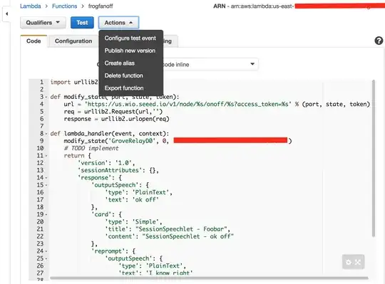

Create an AWS developer account & AWS account.
In the AWS console
  • Create a lambda function. Include in the lambda function some code that will access the API. This can either be python or java or node.js.
Here is a python script. Change modify_state to be either 1 or 0
import urllib2
def modify_state( port, state, token):
    url = 'https://us.wio.seeed.io/v1/node/%s/onoff/%s?access_token=%s' % (port, state, token)
    req = urllib2.Request(url,'')
    response = urllib2.urlopen(req)
def lambda_handler(event, context):
    modify_state('GroveRelayD0', <STATE:0:1>, '<APIKEY')

  • Make sure to publish new version (copy the ARN in the top right, you'll need it later)
aws lambda code

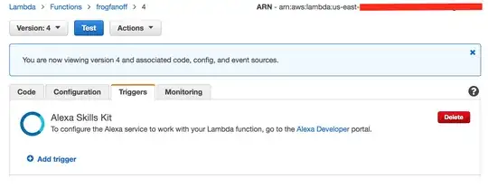

  • Set the 'trigger' to alexa skills
aws trigger configuration

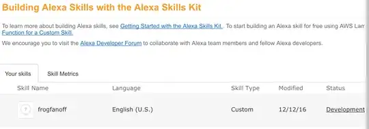

In the developer console
  • Create a skill create a skill dialog

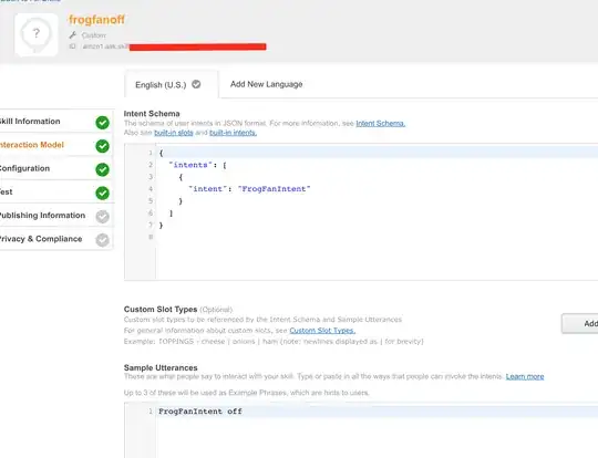

  • Create an Interaction Model with an intent, and a sample utterance intent schema dialog

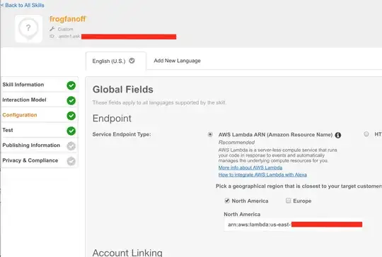

  • Link the endpoint
endpoint configuration dialog
You can skip the last 2 steps. The skill will run in development mode and only you will be able to access it. Complete the last 2 steps only if you want to share your skill with anyone in the world.
