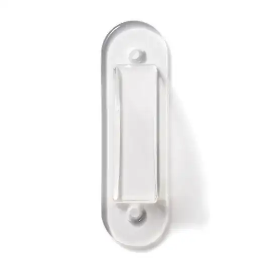

There are plasctic switch covers you can put on over your traditional switch. They are covered in the front to prevent accidental toggles, but open on one side so you have access if you need it. I have several on switches that I've put smart bulbs on.
Here's one example: Style Selections 1-Gang Clear Single Switch Guard Wall Plate
Picture of said wall plate
