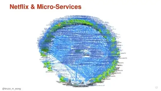

Secondly it gives the user the expressed right to get all the data that the company has stored about him or her. That means every data in every system that can be tied to the specific user has to be provided. You can imagine that in bigger companies where all sorts of systems hold data that's somehow connected to a user that is kind of a hassle. I guess Netflix has some fun with that if you look at their systems:
Netflix Services Source (Slide 12)
