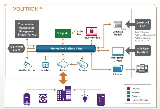

You could try the VOLTTRON platform for this. You will need to do some programming to get everything set up, but they have a lot of functionality for
  • Database Usage
  • Built in Web UI
  • External HTTP Requests
Here is a picture that describes their platform better I can, taken from some of their documentation. enter image description here
