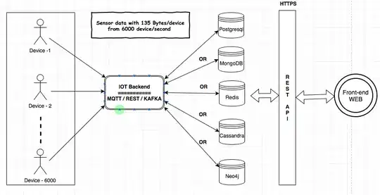

I have to provide the IoT service for my customer. MQTT, Kafka and Rest Services components will be used to ingest the data from the devices to the database. I need to do some analytics over the data in the backend. The data size would be 135 bytes/device and 6000 device/second. I have shared the architecture here to understand the requirement and components.
I have investigated about the data stores(MongoDB, Postgresql(TimescaleDB), Redis, Neo4j, Cassandra) and every vendors proved that their database is suitable for the IoT use-case. I have confused about using the proven/most reliable/scalable database for the IoT.
What could be the best suitable database to ingest this much of data and do the analytics?
Is there any proven benchmark for the suitable database for the IoT?
Please give your thoughts and suggestions.

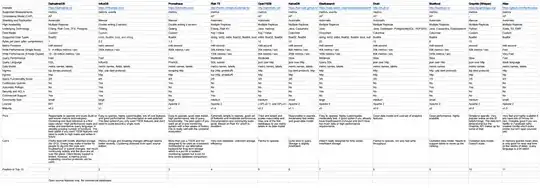

The question is broad and no accurate answer can be given, but these links can help:
http://outlyer.com/blog/top10-open-source-time-series-databases/ enter image description here
Followup with benchmarks: http://outlyer.com/blog/time-series-database-benchmarks/
Other comparison: https://gist.github.com/sacreman/00a85cf09251147175241d334aafa798
I set some rules to attempt to limit the scope otherwise this blog would never end.
Only free and open source time series databases and their features have been compared. Therefore is someone asks “have you tried Kdb+ and Informix?” the answer will be no. They are probably awesome though.
The list will only include databases that either classify themselves in their marketing material as time series, or have been written about in a blog by a cool company as something they are using for time series data.
What has been done is reading the official docs, reading StackOverflow, looking through Github issues and code and generally hacking the information together. With this in mind some facts may be incorrect.
If anyone spots anything factually wrong please let me know and I’ll update the blog.
Benchmarking has been based on marketing claims and estimation. Why? Because benchmarking is a sizeable chunk of work and prone to error. You always get “you should have tuned this special undocumented setting”. The numbers listed are highly favourable to most databases. They are either the numbers blogged about or claimed on Twitter at some time in the past. If you feel any numbers are wrong let me know and I’ll update them.
