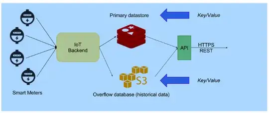

So If I use the below simple architecture with the use of Redis/MongoDB/CouchDB/Any GraphDB NoSQL layer and S3 as the storage to store historical data. So the cost would be very much low.
Workflow:
  1. Ingest into Redis/MongoDB/CouchDB/Any Graph DB,
  2. Copy into S3 over time and
  3. Expire in Redis/MongoDB/CouchDB/Any Graph DB.
So the NoSQL layer will have only the recent data and the S3 will have the historical data.

As you specially asked me to look into this question I will post some kind of advertising, because again, I think that your project can be reached with lower amount of running cost, with higher performance and significantly faster implemented by using already specialized in this platforms or services.
More specifically - you can use approach described in the article event-driven web applications development with mqtt.
In your case smart meters can post to the platform via MQTT, HTTP or even UDP with custom payload, platform can store all the historical data for you and provide you with MQTT or REST API to access this data and perform required analytical actions.
In that case simplicity means - you are concentrating on smart meters and on application(portal) for your users and let 3rd party platform do all data flows.
Another approach will be to use MQTT broker, where smart meters publishing there all the data and few non-clean sessions subscribed to the data from meters => one for NoSQL DB-engine(any of), another one for constant delivery historic data to S3, may be another to send same messages to front-end. In such approach you will make these processes unrelated and have more choices to change systems during lifetime of your project.
