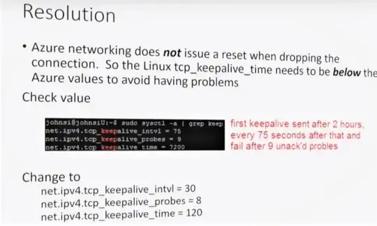

Just to complete this question.
As worked out in the comments. It looks like Azure's router drops connections that have been idle for 5 mins. See this Stack Overflow answer for details: https://stackoverflow.com/questions/16840834/are-established-network-connections-to-azure-endpoint-terminated-by-firewall-or

This.
tcp_keepalive_time
I can't remember where I captured this from, so I'm unable to link to source. All pinpoint accurate information though.
Yes, Microsoft should bake in more appropriate values into their Azure Linux images.
