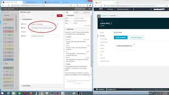

The NODE-RED subscriber is just another device in your Greengrass group that you need to allow to subscribe.

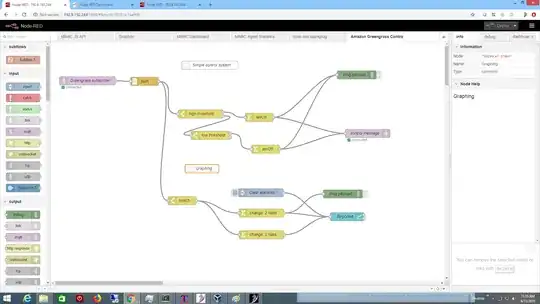

When the actuator (eg. cooling system) in the control system is off, the sensor temperature heats, and when it is on, then it cools. We implemented the control system logic in a Node-RED flow, rather than in a Lambda function.
It turns the actuator on if the temperature exceeds a high threshold, and turns it off if the temperature is cool enough. The connectivity to the core broker is setup as a subscriber to the shadow updates as shown below on the right:
