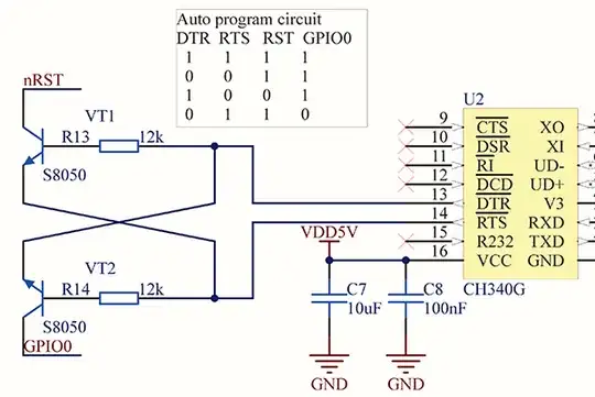

On a NodeMCU this pin is pulled to high by default and controlled by the automatic bootloader circuit if flashing is needed. The TTL - USB converter chip controls the RESET and GPIO0 with its RTS and DTR pins and makes sure that the ESP8266 enters bootmode before program download starts.
As you are bypassing this chip the ESP8266 probably does not enter boot mode any you cannot program it.
What you should do is connect the GPIO0 to GND, then reset the ESP8266 and after that the ESP8266 should be in bootloader mode and ready to be programmed using its RX and TX pins directly.
Mind that GPIO0 should be tied to GND only for the duration of the reset.
