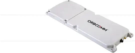

If you are willing to spend in order of US $500 per sensor, then I can recommend a solution using an inexpensive satellite modem. Although this might sound expensive, think of the cost spread over many years, and be aware that in addition to the sensors, you can program the satellite modems themselves, if need be.
I have had lots of fun with Skywave’s offerings (they have now rebranded as OrbComm), and you might like to look at the IDP_800.
Read the datasheet.
Mass: with batteries: 1.3 Kg (with integrated antenna Dimensions : 43.2 cm x 14.7 cm x 2.5 cm and it runs on 6 AA batteries, which can be bought almost anywhere.
I send only one 50 byte message a day & they tell me that I can except a three year battery life. Their units generally cost US $500 - $1,000 (with discount for bulk purchases), and their airtime rates are competitive.
The device has built in GPDS and is fully programmable in the LUA scripting language.
Obligatory picture follows: enter image description here

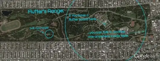

If you are looking for something cheaper, then II would recommend Flutter (see also completed Kickstarter page for more info).
It's a US $20 Arduino board with 1kmn wifi range, so you would still need to use repeaters, but you would certainly need fewer than with conventional WiFi. I would suggest a mesh network, which Flutter supports, and would recommend that you mount them on posts, as high above the ground as you can.
Whatever solution you go for, don't accept manufacturers claims as to range - start with one Flutter/whatever, and start adding more, checking as you go how good communication is. DO NOT put hem all in place first & then go for a big bang turn on.
That's about it really, so now for the obligatory graphic
