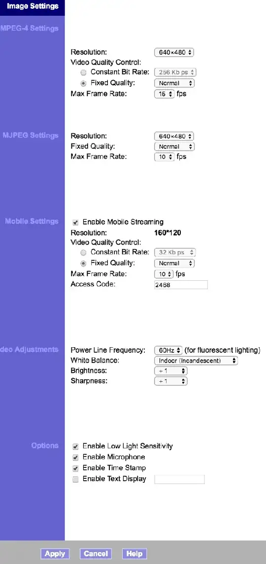

Here are my configuration settings from /adm/image_fs.htm page:
Linksys WVC54GCA Wireless Internet Monitoring Camera, image admin configuration page
The White Balance options (if relevant) can be selected to: Auto, Indoor (Incandescent), Fluorescent (white light), Fluorescent (yellow light), Outdoor or Black & White.

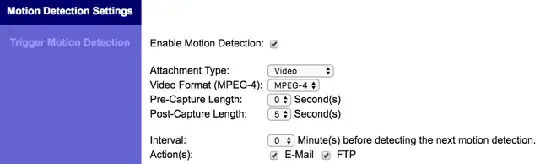

Settings at /adm/event_fs.htm page:
Linksys WVC54GCA, image admin configuration page, Motion Detection Settings, Trigger Motion Detection

That might not work the same for all times of day due to low sun, clouds and other factors changing the lighting. Also cats. Motion detection and cats mix badly. Looking at the now provided options of your settings I'd start with deactivating the low light sensitivity box and check the results. At day and night. This might turn the camera useless at night, but that has to be tested with the actual device.
There is however another setting that might help you out that is listed in the handbook:
Interval Enter the time in minutes that must pass between motion detection events. Valid values are 0-5, 10, or 15. The default is 2. A value of 0 indicates no delay between events.
WVC54GCA User guide
It seems like that setting is set to zero if you get that many mails. Maybe revert it to default or even to five minutes. That should definitely reduce the amount of mails.
