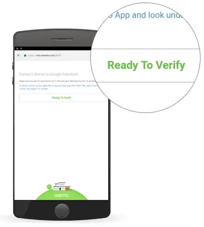

I'm trying to connect my Belkin Wemo smart bulbs to my Google Home (really my Google Assistant via the Google Home app).
Wemo ready to verify Screenshot
I'm following the steps lists on Belkin's Support Site but after I click "Ready to Verify" (step 4), it asks for the name of my network and MAC address. After a little research I found them but it's saying I've entered the wrong details.
How do I make Wemo and Google play nice?
  • I've tried to update the firmware on my Wemos, but it looks like they're up to date.
  • I'm running the latest versions of all apps.
  • I've also tried to connect my Amazon Alexa to the Wemos and got stopped on the same screen.
