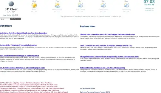

Not sure if this is the right platform (please let me know any recommendations if not), but I made a display monitor in the Raspberry Pi to pull in information such as news feeds, weather, local news and sports scores. I'm trying to learn more about IoT for an assignment and would like to use my Pi project as an example.
As of now, it's just a monitor that pulls in feeds. Does this constitute an IoT device or does the information need to be relayed back somewhere?
I'm a beginner, but I was hoping someone might have some recommendations in how I could make this a true IoT device if it isn't currently. Thank you.enter image description here

The core idea of the Internet of Things is to have small computing devices which provide a specific, targeted interface to some thing or event or device. The small computing device collects measurements of various kinds and/or it is used to modify the state of the thing or event or device.
A specific example is an automated weather station in which a small computing device has various sensors attached and the computing device samples the sensors and collects the various measurements reported by the sensors and then provides those measurements to some other device.
Another would be an automated digital camera that is set up so that when wildlife passes by the camera takes photographs and then sends the photographs to some of device for processing or review.
What you have done is no different than what could be done and often is done with a standard workstation. It is not really an Internet of Things application as something similar is available on my Windows 10 desktop computer for instance.
