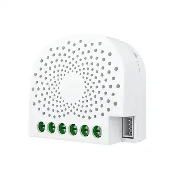

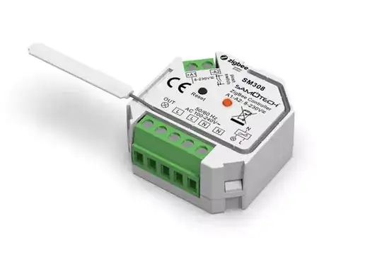

In 2024, you can buy these off the shelf. I am using Fibaro z-wave devices, but any Z-wave or Zigbee device will do the job. On most of them, there is no master device, you can configure them for multi-way switches. And these devices are designed to fit behind your wall switch.
They do require either a zwave or zigbee server or a stick to plug into your desktop. You can also link them to Alexa.
Two examples -
