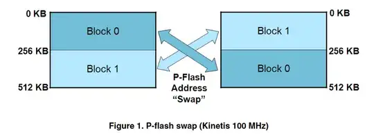

Freescale Semiconductor describes a robust way of over-the-air firmware upgrade for their Kinetis Microcontrollers.
It is called: Program Flash Memory Swap.
Systems using flash memory swap
In devices with two or more internal flash blocks that support swap, the memory base address of each flash block can be exchanged. The address location of each flash block will thus be swapped in the logical memory map of the device. After a reset, the built-in flash swap system essentially selects which software executes by the location of the flash block in the logical memory map. This allows a code back-up system with the added ease of programming. You can execute out of one block while erasing/programming the other block. On Kinetis devices, the flash swap system monitors/controls all the steps of switching from the old application to new; there is an added assurance of reliable operation in the case of a power loss during one of those steps.
Advantages
  • Ease of programming. Application always executes out of the lower block in the memory map.
  • Power loss tolerant.
  • No bootloader required. No delay to the start of the main application.
  • Well suited for a multi-tasking OS. Minimal application downtime. In a multi-tasking system it is possible to continue to execute the main application tasks while background tasks are running to update the new copy of the application.
  • Backup copy of code. Possible to revert to the known working application.
Disadvantages
  • Additional flash memory space required to store backup copy.
You can update blocks and then swap them.
memory swap during update visualized
The document linked holds detailed description.
It ensures safer firmware upgrades but as it requires more flash memroy, certainly costs more. Also not applicable for any type of microcontroller, only those which support internal flash blocks swap.
