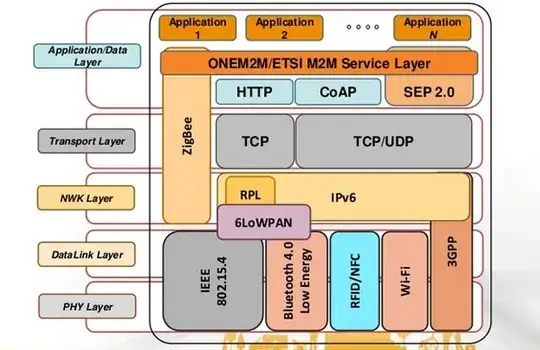

After the comment below I admit my answer was quite partial, so I examined and found a little more:
Even the communications have this kind of mess of standards, if all calculated:
http://www.slideshare.net/butler-iot/butler-project-overview-13603599
Source: EU Butler Project - Communication Issues

Like seen in the list of each examples, there are plenty of them and also more custom and proprietary ones surely are there.
You should open that link and read it through, it is mind blowing. I believe you may encounter in your project(s) many of these, at least if the sensors are of heavily packed form, ie. not only components in purest format, but parts of some already existing ecosystem. In those cases you maybe cannot negotiate the way you interface them, you just have to select between ecosystems.
