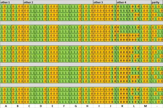

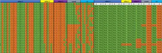

EDIT: I've put the data into excel and added some function (it basically compares each 4 bit with the ones from above - the last transmission). I've done that as I recognized the CRC stayed the same once. This was the case when both action and count were raised by 1. Please have a look:
data

And here is it again as fancy excel:
Does anybody know how to calculate that parity? I've tried splitting the data etc. and using usual parity calculations but unfortunately with no success yet.

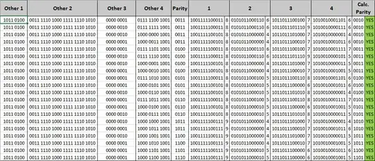

Oh man, don't ask me how but I think I figured it out.
Let's have a look:
Basically you split the data up into packets of 4 bits each. You then concat each first, second, third and fourth letter together separately. This can be seen in the 1, 2, 3 and 4 columns. Afterwards you count the 1s in each of them (the number of ones is written beside each of them). If they are even it's a 0 for the parity bit, if they are odd it's a one. So before you are finished you now have to binary add 1 to the result from before (!). That matched every single time and I was successfully able to generate my own frames that way. Problem solved it seems. Perfect. Thanks a lot everybody for contributing.
