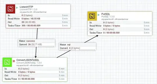

Yes, and since Kylo is based on top off Apache NiFi, you can start with NiFi documentation.
Great starting point for Apache NiFi can be Apache NiFi Videos and video Build a Simple Flow - Part1
Good references are Apache NiFi JIRA pages. All what you have to do in first step is to create three(3) basic processor objects:
1) Receiving yours sensor data on TCP/HTTP [ListenHTTP Processor]
2) Transferring yours incoming JSON into SQL statements [ConvertJSONtoSQL Processor]
3) [PutSQL Processor] can write all data received into yours MySQl/PostgreSQL database.
NiFi screen shot
In addition, I would advise very nice online presentation on this LINK.
