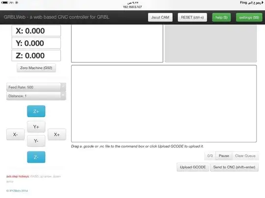

I am using Raspberry Pi as a web server this web is to control CNC machine as you can see in the following picture.
CNC controller UI
(I took it from git hub)
I can enter the g code manually or I can upload the g code file but now I want to connect this web page to Amazon Web Services IoT to send g code automatically to my page,after a long search i found this link it shows how to connect a web app to AWS IOT , but i think i am still need help with those things because i don't really understand how to apply it . Here is server.js file:
