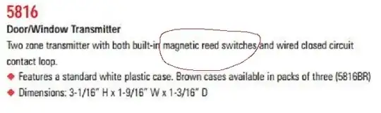

Based on the information provided so far, it can be concluded that ADT and Honeywell have provided a good home security system. Why? There is no public technical infomation on the wireless transmitter used in Honeywell 5816 Wireless window and door sensors.
It looks like Honeywell has white labeled the wireless door and window sensor from Ademco Security
Available options:
Based on the below snippet it looks like the window and door sensor is using a magnetic reed switch.
[Ademco Wireless Transmitter[2]
It might be fairly simple to develop a simple electronic circuit to probe the reed switch and transmit the data to the SmartThings system.

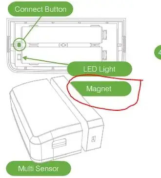

Looking at the Samsung SmartThings Multipurpose Sensor it looks like they might be using a magnatic reed switch.
Smartthings Sensor
So from a cost and time standpoint you might be better off purchasing a SmartThings multipurpose sensor and ditch the Honeywell sensor.
